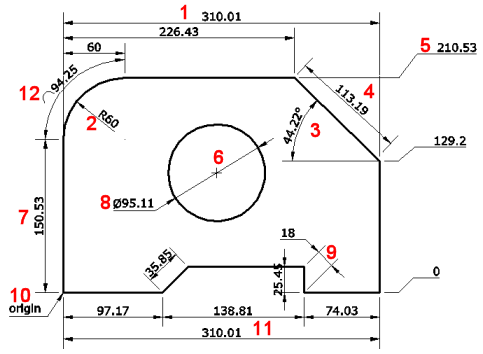

Dimensioning Concepts
In Bricscad there are five dimension types: linear, angular, radial, diametric and ordinate.
Dimensions are created by either selecting an entity or by  identifying the origin points of the extension lines.
  1. Stacked baseline dimension
  2. Radial dimension
  3. Angular dimension
  4. Aligned linear dimension
  5. Ordinate dimension
  6. Center mark
  7. Vertical linear dimension
  8. Diametric dimension
  9. Rotated linear dimension
  10. Leader with text
  11. Horizontal linear dimension
  12. Arc length dimension
