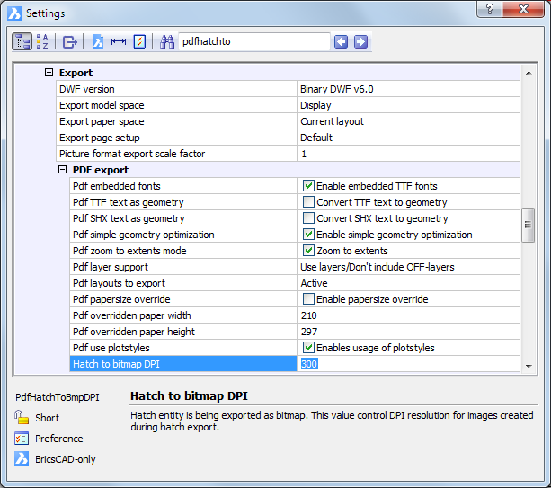

Displays the PDF Export section of the Settings dialog box:
Choose options, and then click the X to exit the dialog box.

Pdf embedded fonts
Determines whether TTF font files are embedded in the PDF file:
  • Yes - includes fonts, which may violate the copyright on some fonts.
  • No - does not include fonts, which may result in missing fonts if the receiving computer does not have the required SHX or TTF files.
Pdf TTF text as geometry
Determines whether TTF (true type fonts) are exported as geometry:
  • Yes - explodes fonts into lines and arcs.
  • No - does not explode fonts.
Pdf SHX text as geometry
Determines whether SHX (shapes compiled) are exported as geometry:
  • Yes - explodes font into lines and arcs.
Pdf simple geometry optimization
Determines if the geometry is simplified to reduce file size:
  • Yes - optimizes geometry, such as turning multiple segments into a single polyline.
  • No - does not optimize geometry.
Pdf zoom to extents mode
Determines if the drawing is zoomed to extents:
  • Yes - zooms drawing to extents, which ensures the drawing matches the paper size.
  • No - does not zoom the drawing, which ensures the drawing is exported as-is.
Pdf layer support
Determines how layers are exported:
  • Don't use layers - removes all layer information.
  • Use layers/Don't include OFF-layers - excludes layers that are turned off.
  • Use layers/Include OFF-layers - exports all layers. See Layer command.
Pdf layouts to export
Determines which layouts to export:
  • Active - exports the current layout.
  • All - exports all layouts. Each layout is plotted to a separate page in the PDF file.
Pdf  papersize override
Determines whether page size is specified:
  • Yes - uses the custom page size specified below.
  • No - does not use specified page size.
Pdf overridden paper width
Specifies the width of the page, in mm or inches.
Pdf overridden paper height
Specifies the height of the page, in mm or inches.
Pdf use plotstyles
Use plotstyles when exporting to pdf.
Hatch to bitmap DPI
Controls the dots per inch (DPI) resolution for bitmaps when exporting solid and gradient hatches to PDF.
