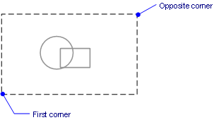

Window |
W |
Selects all entities fully inside a rectangular selection window; prompts you: First corner of inclusive window - specify the first point of the selection rectangle. Opposite corner - specify the other corner.

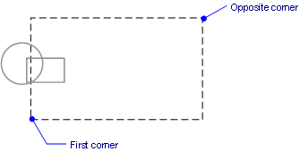

Crossing |
C |
Selects all entities inside and crossing a rectangular selection window; prompts you: First corner of crossing window - specify the first point of the selection rectangle. Opposite corner - specify the other corner.

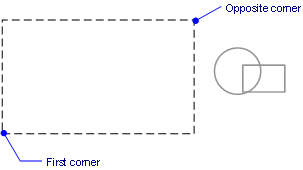

Outside |
O |
Selects all entities fully outside a rectangular selection window; prompts you: First corner of exclusive window - specify the first point of the selection rectangle. Opposite corner - specify the other corner.

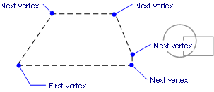

Window polygon |
WP |
Selects all entities fully inside a polygonal selection window; prompts you: First vertex of inclusive polygon - specify the first point of the selection polygon. Next vertex - specify the next point. Next vertex - press Enter to close the vertex.
Crossing polygon |
CP |
Selects all entities inside and crossing a polygonal selection window; prompts you: First vertex of crossing polygon - specify the first point of the selection polygon. Next vertex - specify the next point. Next vertex - press Enter to close the vertex.
Outside polygon |
OP |
Selects all entities fully outside a polygonal selection window; prompts you: First vertex of outside polygon - specify the first point of the selection polygon. Next vertex - specify the next point. Next vertex - press Enter to close the vertex.

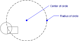

Crossing circle |
CC |
Selects all entities inside and crossing a circular selection window; prompts you: Center of circle - pick a point. Radius of circle - specify a radius by picking or entering a value.
