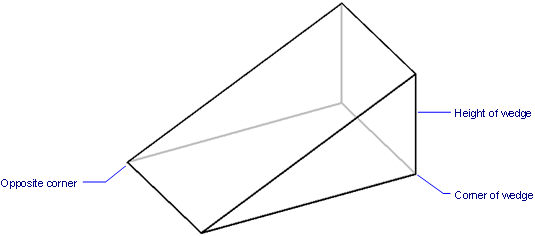

Center/<Corner of wedge> <4.25,0.00,1.84>: (Pick a point, or enter coordinates.)
Cube/Length/<Opposite corner>: (Pick another point, or enter an option.)
Height of wedge: (Specify the height, or pick two points.)
Specifies one corner of the wedge's base. |
Specifies the other corner of the base. |

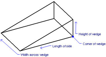

Specifies the height of the wedge. Note that the tall end of the wedge is drawn from the first corner point specified. |

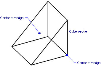

Draws the wedge using a center point and a corner. Prompts you: Center of wedge - specify the center of the entire wedge (not the base). Corner of wedge - specify the location of one of the wedge's corners. |
Draws a wedge with equal length, width, and height. Prompts you: Length of sides of cubic wedge - specify the same distance for each dimension, length, width, and height. |
Allows you to enter distances of all three dimensions; don't enter coordinates. Prompts you: Length of side - specify the length in the x direction; enter a negative number to draw the wedge in the negative x direction. Width across wedge - specify the width of the base. Height of wedge - specify the height. |
