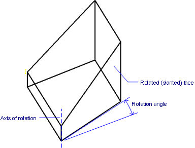

Rotate
Slants the selected face about an axis; prompts you:
Select faces: Remove/Undo/ALL - choose the face(s) to change.
Select faces: Remove/Undo/ALL - press Enter to continue.
Specify the base point - pick the first point of the axis of rotation.
Specify another point along the axis -  pick the axis of rotation's second point.
Specify the rotation angle - enter an angle:
  • Positive angle - face rotates counterclockwise around the axis.
  • Negative angle - face rotates clockwise.
See Rotate command.

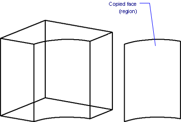

Copy
Copies faces; selected faces turn into regions.
Prompts you:
Specify <Base point>/Vector - pick a point, enter x,yz, coordinates, or type V.
Specify end point - pick another point.
