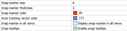

To define the Entity Snap settings
Open the Settings dialog.
In the Settings dialog, expand the Program Options settings class.
Under Program Options expand the Display settings group, then scroll down to the Entity Snap settings.
Under Drawing expand the Drafting settings group then go to Coordinate Input > Entity Snaps.
Define the Entity
Snap settings.
User Preference |
Title |
SnapMarkerSize |
Snap marker size |
Sets the size of the snap marker. (default size is 6) |
SnapMarkerThickness |
Snap marker thickness |
Sets the thickness of the snap marker. (default thickness is 2) |
SnapMarkerColor |
Snap marker color |
Sets the color of the snap marker. (default color = 20) |
DisplaySnapMarkerInAllViews |
Snap marker in all views |
If multiple viewports are open, enables the display of the snap marker in all viewports. |
DisplayTooltips |
Snap tooltips (3) |
Enables the display of the Entity Snap tooltips. |

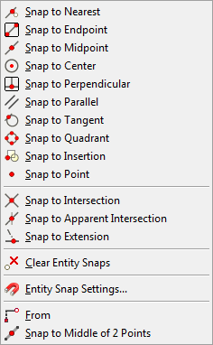

Do one of the following:
Click the buttons on the Entity Snaps toolbar.
The buttons of the currently active entity snap modes are
pressed.
Press and hold the Shift key, then right
click and select the Entity Snap mode in the context menu.
The icons of the currently active Entity Snap modes are
outlined.
When no command is active, the above procedures toggle the Entity Snap modes on/off.
When a command is active, the above procedures set a 'one shot' override of the current Entity Snap modes.
Name |
Icon |
Marker |
Snaps to the nearest point on an entity. |
Snaps to the nearest endpoint of an entity or polyline segment. |
Snaps to the midpoint of an entity or polyline segment. |
Snaps to the center point of an arc, circle, polygon, ellipse or elliptical arc. Snaps to the center of gravity of a closed polyline. |
Snaps to the perpendicular point of another entity. You can snap to an arc, circle, ellipse, line, polyline, infinite line, ray, spline or edge of a plane to form a perpendicular alignment with that entity or with an extension of that entity. |
Displays a tracking line parallel to the selected entity. |
Snaps to the point on an arc, ellipse, spline or circle that, when connected to the previous point, forms a line tangent to that entity. |
Snaps to the closest quadrant of an arc, circle, ellipse, or elliptical arc. |
Snaps to the insertion point of an attribute, block or text entity. |
Snaps to a point entity. |
Snaps to the intersection of any combination of entities. |
Snaps to the apparent intersection in the current view of two entities that do not intersect in three-dimensional space. |
Snaps to the extension of an entity or to the intersection of the extension of two entities. |
Turns off all entity snap modes. |
Prompts for a base point. Use relative coordinates to define the offset from the base point. |
Snaps to a point in the middle between two points. |

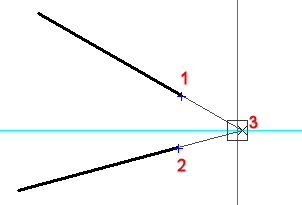

To snap to the extension of two entities
If not already on, turn on the Extension Entity Snap mode ().
Launch a drawing tool, e.g. Draw Line.
Move the cursor over the endpoint of the first
entity (1).
A small cross (
) indicates the entity is
marked for extension.
Move the cursor over the endpoint of the second
entity (2).
A small cross (
Move the cursor near the intersection of the
extensions of the two entities.
An X indicates the intersection (3).
Click to accept the snap point.
