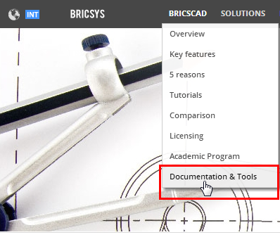

To download the tablet overlay and CUI files
Go to the BricsCAD Documentation and Tools page on the Bricsys website.
Scroll down to the bottom of the page and click the DOWNLOAD button under Tablet overlay.

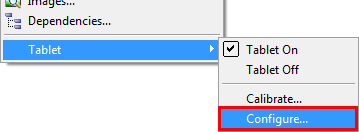

Do one of the following:
Choose Tablet
in the Settings menu, then
choose Configure... in the flyout
menu.
Type tablet in the command bar and press
Enter.
The command bar reads: Tablet:
ON/OFF/CALibrate/ConFiGure/<On>:
a prompt menu displays:
Type cfg in the command bar and press
Enter or choose Configure in the
prompt menu.
The command bar reads: Do you want to align the tablet overlay? Yes/No/<No>:
Type Y in the command
bar and press Enter or choose Yes in
the prompt menu.
The command bar reads: Digitize upper left corner of the
overlay:
Click on the mark in the upper left corner (1) of
the digitizing tablet overlay.
The command bar reads: Digitize the lower left corner of the
overlay.
Click on the mark in the lower left corner (2)
of the digitizing tablet
overlay.
The command bar reads: Digitize the lower right corner of the
overlay.
Click on the mark in the lower right corner (3)
overlay.
The command bar reads: Digitize the lower left corner of the screen
pointing area:
Click on the mark at position (4) on the of the
The command bar reads: Digitize the upper right corner of the
screen pointing area:
Click on the mark at position (5) on the of the
The command bar reads: Tablet configured.

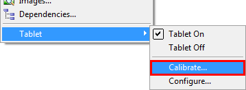

Choose Tablet
choose Calibrate... in the flyout
menu.
Enter.
Type cal in the command bar and press
Enter or choose Calibrate in the
prompt menu.
The command bar reads: Digitize point #1:
Click a point on the digitizing tablet .
The command bar reads: Enter coordinates for point #1:
Click a point in the BricsCAD drawing window.
Enter the coordinates (x,y) in the command bar.
The command bar reads: Digitize point #2:
Repeat step 3 to specify the following calibration
point.
The command bar reads: Digitize point #3 (or ENTER to end):
Repeat step 4 to specify an additional
calibration point.
(You can specify up to 10 calibration points).
Press Enter to conclude the calibration
process.

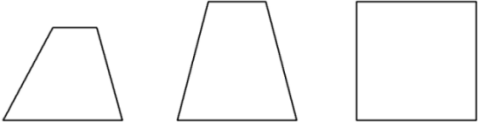

Transformation refers to the calculation of the points on the
screen that correspond to points you digitize on the tablet.
Orthogonal (left): To be used with accurate paper drawings. Orthogonal transformation maintains all angles and preserves relative distances. If only two calibration points are specified orthogonal transformation is generated automatically.
Affine (middle): Maintains parallel lines, but not necessarily the angles between intersecting lines.
Projective (right): Does not maintain parallel lines, nor angles.
