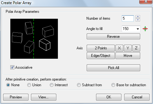

The Associative option of the XARRAYP command creates a composite solid as a polar array by copying and rotating a primitive or composite solid about an axis.

Do one of the following:
Click the Polar
Array tool button (
) on the X-Tools toolbar.
Choose Polar Array in the X-Solids > Tools menu.
Type xarrayp in the command bar.
The command bar reads: Select Entities:
Select one or more primitive or composite solids.
Right click or press Enter to stop selecting solids.
The Create Polar Array dialog box displays:
(option) Check the Associative option.
If checked, the array is created as a composite solid.
(option) Click the Pick All button to define all array parameters in the drawing.
To define the number of items, do one of the following:
Type the number in the Number of items field.
Press the 'up' and 'down' buttons until the desired number displays.
To set the angle, do one of the following:
Type the angle in the Angle to fill field.
Choose the angle from the previously used angles list.
Click the Pick button
) to specify the angle in the drawing.
(option) Click the Reverse button to reverse the angle direction.
To define the axis do one of the following:
2 Points: You are prompted to specify two points.
X, Y, Z: Uses the X-, Y- or Z-axis of the current UCS.
Edge/Object: You are prompted to select a linear entity (line, ray, infinite line, ...) or an edge.
(option) Click the Move button to move the axis.
You are prompted in the drawing to specify a point. The axis is
moved parallel.
(option) Click the View... button to manipulate the view.
(option) Click the Preview button.
(option) Choose an After primitive creation operation to be executed after the X-Solid box is created.
Click the OK button
to create the polar array.
If the arrayed solids overlap each other, they are unified if the
Associative option was checked.
