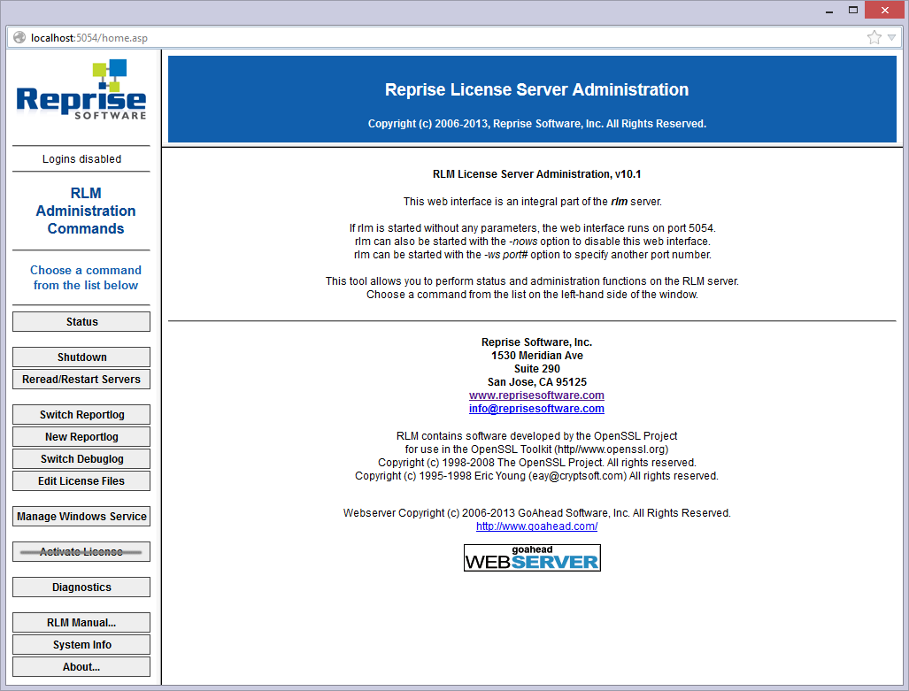

When the network license server (also named RLM License server) is running, it can be configured using the Reprise License Server Administration web interface.
The web interface
  1. (If the network license server is not running) In the Start menu, click the License Server shortcut (on Windows Vista or higher: right-click > Run as administrator).
    A console window opens.
  2. Start a web browser.
  3. Go to http://localhost:5054. The Reprise License Server Administration web interface opens.

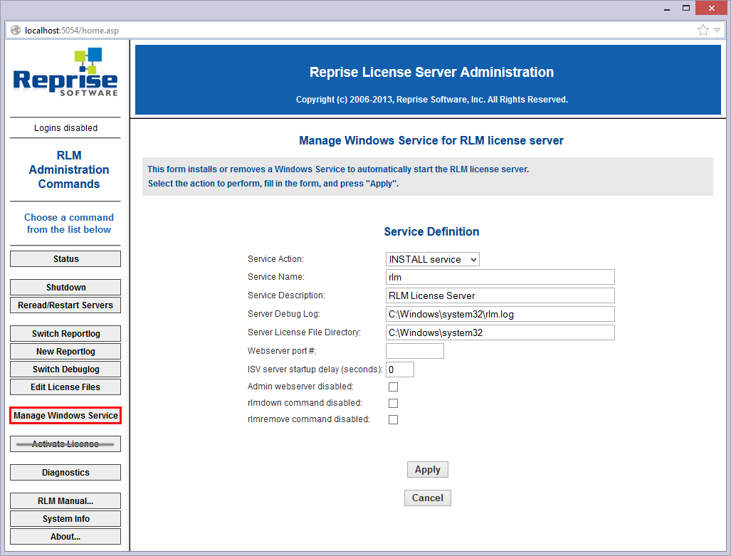

  1. Click the Manage Windows Service button on the left. The Manage Windows Service for RLM license server page opens.
  2. Click the Apply button.
The service is now installed but not started because the server is already running.
The next time the server computer will be booted, the service will start the network license server automatically.

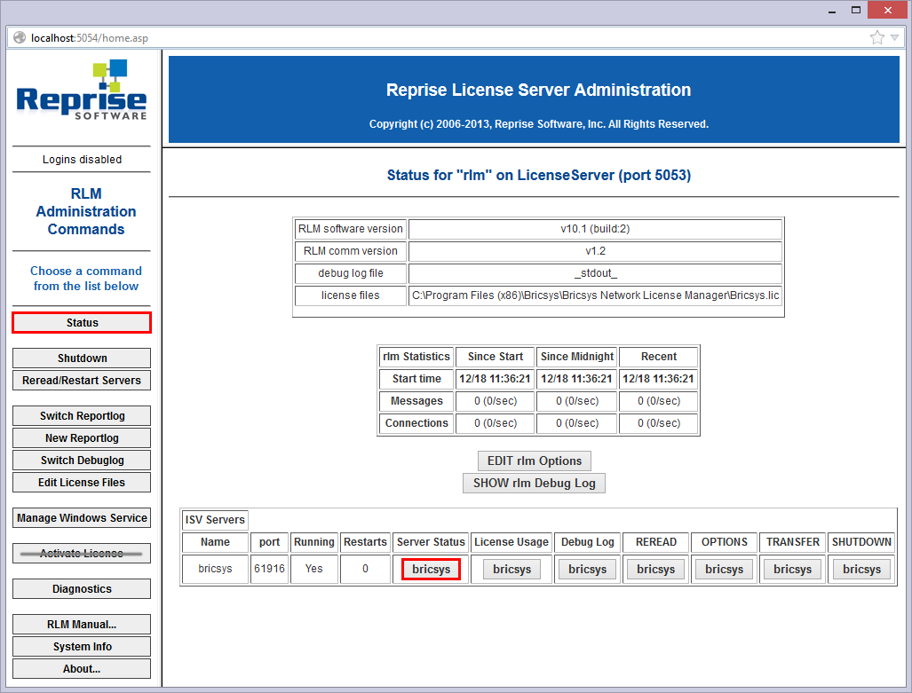

  1. Click the Status button on the left. The page Status for "rlm" on [LicenseServer] (port 5053) opens.
  2. Click the bricsys button in the Server Status column of the ISV Servers table to view the status of the Bricsys Network license.

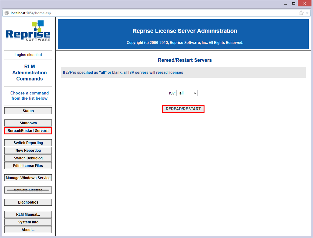

After activating a Network license while the server was running, you have to reread the license / restart the server.
  1. Click the Reread/Restart Servers button on the left. The Reread/Restart Servers page opens.
  2. Click the Reread/Restart Servers button. The server restarts and rereads the Network license.
