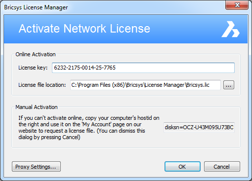

In the Start menu, click
the License Activation
shortcut. The Activate Network License
dialog box opens.
In the License key field,
enter your Network license.
In the License file location field,
the location of the license file must be the Bricsys Network
License Manager installation folder.
Click the OK button.

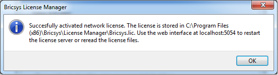

Once the Network license is activated and the server is started, the server is ready to serve licenses.
It is now possible to use the Network license in BricsCAD, on a client computer.
