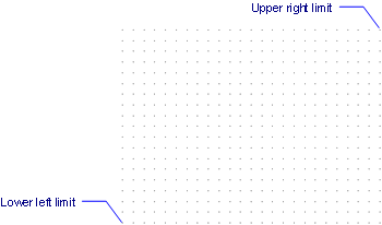

Limits the extent of the drawing and the grid.

Lower left corner
Specifies the lower left corner of the limits.
Upper right corner
Specifies the upper right corner of the limits.
