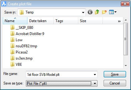

Write the plot to a file
  • Yes - plots the drawing to a PLT file.
BricsCAD displays the Create Plot File dialog box.
Specify a file name, and then click Save.
  • No - plots the drawing to a printer or other output device.
