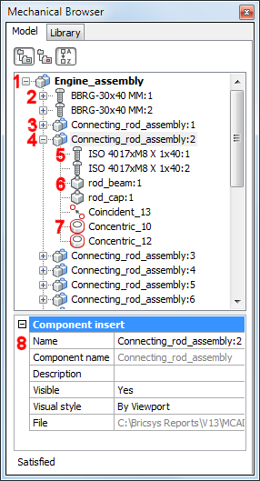

The Mechanical Browser allows navigation on the hierarchy of mechanical components for the current drawing and calling different commands for the inserts.
  1. Component Name
  2. Standard Part Component Insert (= block reference)
  3. Collapsed Component Insert (= external reference)
  4. Expanded Component Insert (= external reference)
  5. Standard Part Subcomponent Insert (= nested block reference)
  6. Subcomponent Insert (= nested external reference)
  7. 3D geometrical constraints
  8. Properties of the selected item

Main Component context menu
Right click the main component name:

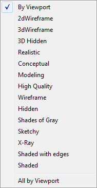

  • Visual Style: Displays the Visual Style menu. Visual Styles that are saved in the current drawing are available.
  • By Viewport: Renders the selected component of the assembly according to the current viewport shademode (See the ShadeMode command).
  • All by Viewport:  Renders all the components of the assembly according to the current viewport shademode  (See the ShadeMode command).
  • By Viewport: Renders the selected component according to the current viewport shademode (See the ShadeMode command).
  • All by Viewport:  Renders all sub-componets according to the current viewport shademode (See the ShadeMode command).

  • Visual Style: See Component context menu.

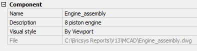

Main component properties
Click the main component name:
  • Click the Name field to edit the main component name.
  • Click the Description field to type a description.
  • Click the Visual style field, then select a visual style from the list button.
    The selected visual style is applied to all components and subcomponents in the assembly.

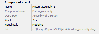

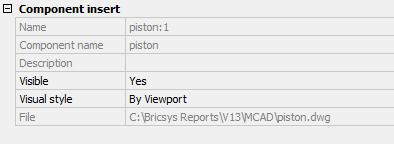

Component insert properties
Click the component name:
  • Click the Name field to edit the insert name.
  • Click the Visible field, then select Yes or No from the list button.
    If set to Yes all subcomponents of which the visibility is On are visible.
    If set to No, no subcomponents are visible, regardless their visibility setting.
    The selected visual style is applied to the component insert, visual styles of the subcomponents different from By Viewport are not affected.
