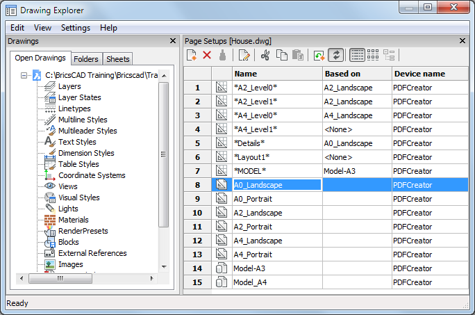

Creates and edits page setups for plotting drawings in the Drawing Explorer.
command bar:  pagesetup
menu bar:  File | Page Setup
toolbar:  Layout |
: pagesetup
Displays the Drawing Explorer - dialog box:
Do one of the following:

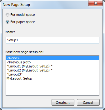

When creating a new page setup you have to choose between Model space or Paper Space, then click the Create... button.

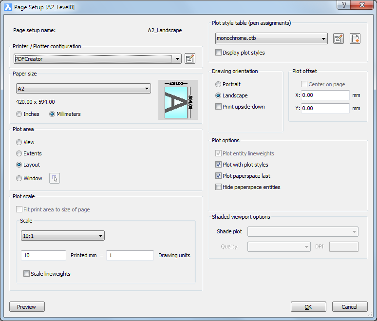

The Page Setup dialog box displays:
Choose options, and then click OK.

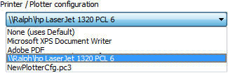

Print / Plotter Configuration
Selects the printer or plotter.
BricsCAD works with any output device installed on the system, including networked printers, print to file, faxes, and PostScript devices.
It also uses predefined printer parameters stored in PC3 files. See PlotterManager command.
Edit plotter configuration
Opens the printer's Properties dialog box for customizing the printer's parameters.

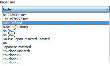

Paper Size
Chooses the size of paper.
You can select standard sizes listed by the droplist; these are sizes supported by the printer.
While printer may appear to support many different sizes, you should select only the size of paper that is actually in the printer.
If User Defined appears in the list, the paper's dimensions are specified by the printer's Properties dialog box.
The image indicates the size, position and orientation of the current plot area on the selected paper size.
Units
Switches paper measurements between imperial and metric.
Plot Area
Specifies which area of the drawing to print:
  • View - prints the current view or a named view. See View command.
Choose a view from the droplist:
  • Extents - prints the extents of the drawing, which ensures every visible entity is printed.
Entities on frozen layers are not taken into account when calculating the extents.
  • Limits - prints the limits of the drawing, as specified by the Limits command.
  • Window - prints a rectangular area of the drawing.
You define the rectangular area by entering x,y coordinates or by clicking the Select Area to be Printed button.
Select area to be printed
Specifies the rectangular area to be printed.
Click the button; the dialog box is dismissed temporarily, and you are prompted:
Select first corner of window - specify one corner of the rectangle.
Select second corner of window - specify the other corner.
You can pick points or enter x,y coordinates.
The Print dialog box returns, with the pair of x,y coordinates added to the Windows Plot Area boxes.
Specifies the x,y coordinates of the lower-left and upper-right corners of the rectangular area to be printed.
You can enter x,y coordinates, or click the button to pick points in the drawing.
Plot Scale
Scales the drawing so that it fits the printable area of the paper.
The scale is calculated automatically by BricsCAD, and takes into account the print area of the drawing.
The printable area is the size of the paper, minus the margins.
The margins are the strips along the four edges that the printer uses for handling the paper.
When this option is turned on, you cannot specify the scale factor.
Specifies the scale factor of the printed drawing.
Choose a scale factor from the droplist, or select Custom to specify a scale factor.
  • 1:1 - prints the drawing full size, with no scaling.
  • Custom - allows you to specify a scale factor.
For scale factors like 1:5, the drawing is scaled smaller.
For scale factors like 5:1, the drawing is scaled larger.
Specifies user-defined scale factors.
For example, to print a drawing of 50'-long house on paper 11" wide, enter:
Printed Inches = 11"
Drawing Units = 50'
BricsCAD works out the scale factor automatically.
Available scales in the list can be edited using the ScaleListEdit command.
