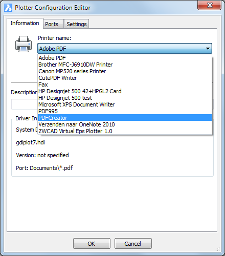

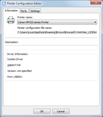

The Plotter Configuration Editor dialog displays:
Select a printer from the Printer name list button.
Edit the settings, and then click OK.
You are prompted to save the new plotter configuration file
Enter a name, and then click OK.

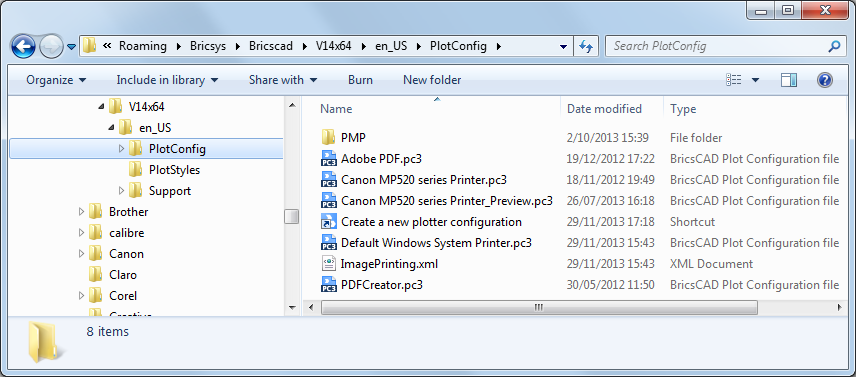

The new PC3 file is added to the C:\Users\<loginname>\AppData\Roaming\Bricsys\BricsCAD\V...\en_US\plotconfig folder.

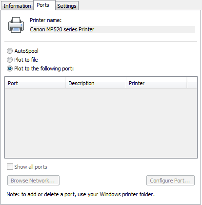

Ports Option
Plot to the following port
Plots drawings to the printer attached to the specified port.
Plot to file
Plots drawings to PLT files. These plot files can be read by other software programs.
AutoSpool
Sends drawings to spoolers, which control how and when drawings are plotted. The spooler software must be set up separately.
Show all ports
Displays the names of all local and network ports found on the current computer.
Browse Network
Opens the Browse Network window. Allows you to locate printers attached to the network.
Configure Port
Opens the Configure Port dialog box. Allows you to configure the selected port.

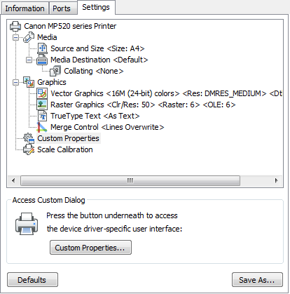

Settings Option
Media
Specifies settings for the media (paper).
Specifies how to collate pages:
None - does not collate; drawings are printed normally.
Regular - prints layouts of each drawing together.
This option is useful when printing multiple copies of drawings with multiple layouts.
Graphics
Specifies how graphics are handled by the printer.
Vector Graphics (currently NOT supported)
Specifies how vector graphics are handled:
Color depth - specifies the number of colors to use.
Color - outputs the drawing in color.
Monochrome - outputs the drawing in monochrome (black).
Resolution - adjusts the resolution; lower resolution is coarser, but prints more quickly.
Dithering - specifies the type of dithering, which simulates more colors at the cost of lower resolution.
Vector graphics are normal BricsCAD drawings made with lines, arcs, and so on.

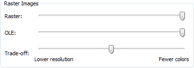

Specifies how raster vectors are handled:
Raster - adjusts how raster images are handled.
OLE - adjust how OLE objects are printed; ranges from:
  • None - does not print OLE entities.
  • Best - prints OLE entities at highest quality.
Trade-off - specifies how BricsCAD should handle drawings with very large raster images that take up much memory:
  • Lower Resolution - prints images with lower resolution but full colors; suitable for photographs.
  • Balance - prints images with as many colors and as much resolution as possible.
  • Fewer Colors - prints images with fewer colors but full resolution; suitable for grayscale images.
Raster graphics are images attached to drawings.
Specifies how TrueType text is handled:
  • TrueType as text - prints text as text; preferred when the printer holds the needed fonts.
  • TrueType as graphics - prints text as graphics; preferred when drawings are printed to files.
Specifies how overlapping lines are merged:
  • Lines Overwrite - specifies that entities with higher draw order overwrite other entities.
  • Lines Merge - specifies that entities are blended to merge their colors; allows entities with lower draw order to be seen.
Custom Properties
Accesses the Custom Properties dialog box.
This dialog box lists properties unique to the selected output device.
Its content varies according the capabilities of the device.
Custom properties are not supported on the Linux platform.

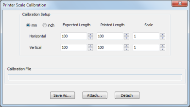

User-Defined Paper Sizes & Calibration
Plotter Calibration
Calibrates the plotter.
Calibrate Plotter - displays the Calibrate Plotter wizard. See below.
This option was necessary in the days of pen plotters, which could go out of alignment; today's inkjet and laser printers not to have the problem.
