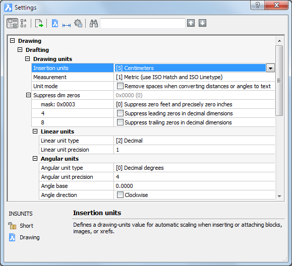

Displays the Drawing Units section of the Settings dialog box:
Change settings, and then click the X button.

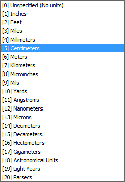

Insertion Units
Defines a real world value for 1 drawing unit.
The INSUNITS system value must be defined properly for automatic scaling when inserting external blocks, images or Xrefs.
Select a unit:

Unit mode
Specifies how imperial units display.
Suppress dim zeros
Allows to suppress leading and / or trailing zeros in decimal dimensions.
Allows to suppress zero feet and zero inches in imperial dimensions.

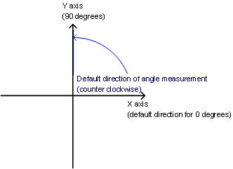

Angle base
Specifies the direction for 0 degrees. The default is the positive x axis.
Enter an angle. You can also rotate the drawing through the Snap command's Rotate option.
Angle direction
Toggles the direction in which angles are measured:
  • No - measures angles counterclockwise (default).
  • Yes - measures angles clockwise.

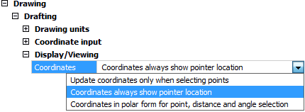

Coordinates
Specifies how coordinates are displayed in the status bar:
  • Update coordinates only when selecting points - equivalent to Off.
  • Coordinates always show pointer location - equivalent to Absolute.
  • Coordinates in polar form for point, distance and angle selection - equivalent to Relative.
