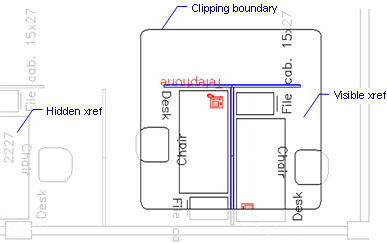

The hidden portion of the xref is shown in gray for illustrative purposes only; it is normally not seen when clipping is turned on.
