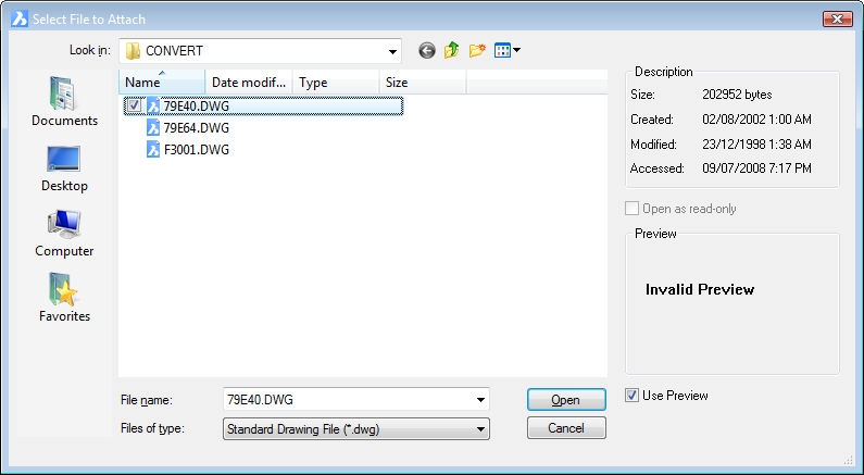

Choose a DWG file, and then click Open.

Attaches xrefs to the current drawing;  displays the Select File to Attach dialog box.

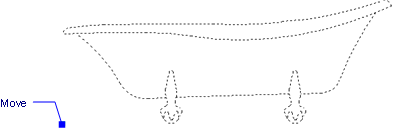

Grips Editing
External references can be edited directly through grips:
  1. Select the xref. Notice that it has one grip at its insertion point.
  2. Drag the grip to move the xref.
