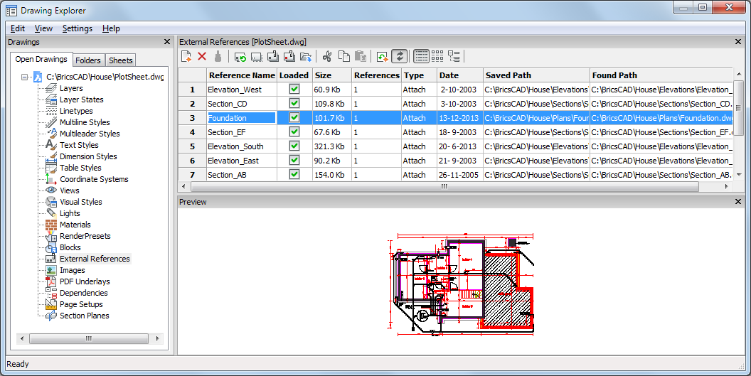

Attaches DWG files to the current drawing through the Drawing Explorer (short for "external reference").
command bar: xref
alias: xr, xa, xattach, expxrefs
menu bar: Settings | XRefs
: xref
Displays Drawing Explorer:
Attach a DWG file, or change the properties of existing xrefs, and then click X.
Press F1 to access help.
Specifies the name of the xref. This name is assigned by BricsCAD, but can be changed by the user. Click to rename. |
Toggles the loading of the xref:
Click to change the load status. |
Reports the size of the xref DWG files. Very large files can slow down the system. |
Reports the number of times the xref is attached to the drawing. |
Reports whether the xref is attached or overlaid:
To change type, you must unload the xref and then reload it as attached or overlaid. |

Displays the details of xrefs:
Displays icons of the xrefs:
Displays the relationship between xrefs in a tree-like view:
Current - current drawing. Column and Floor - xrefs attached to the current drawing. |
Overlay and Attach operate the same way. The difference is in how they treat xrefs that have xrefs themselves"
Overlay attaches only the first level of xref.
Attach attaches all xrefs.
