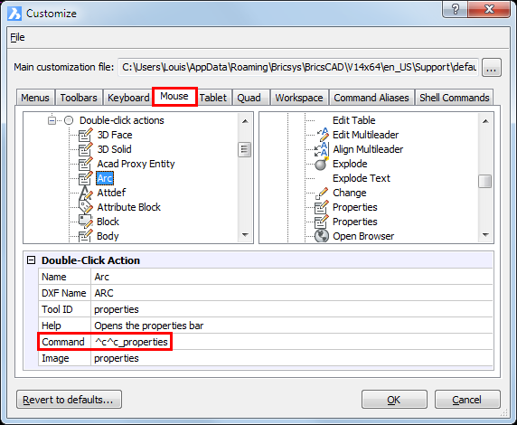

Double click an entity.
The Properties Bar opens, showing the
properties of the selected entity.
Double clicking entities such as texts, blocks or polylines start
an editing command (See the Mouse tab
on the
Customize dialog).

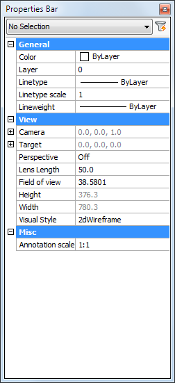

Properties Bar - No selection The
current entity properties, |

Setting the current properties in the Properties Bar
(option) Click on Color,
then click the down arrow button to select a color.
(option) Click on Layer,
then click the down arrow to select a layer.
(option) Click on Linetype.
then click on the down arrow to select a linetype.
scale,
then type the new value in the Linetype
scale field.
(option) Click on Lineweight,
then click on the down arrow to select a lineweight.

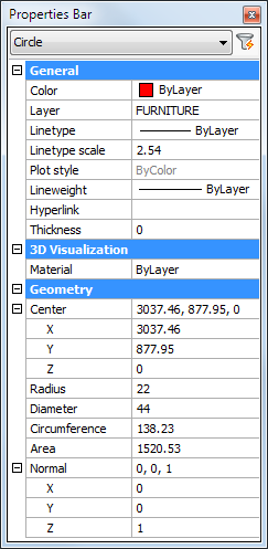

Edit the properties of a single entity
Select the entity.
The entity's properties display in the Properties Bar.
Properties of a circle |
Click the property you want to modify.
The settings field of the selected property is activated.
Type a new value in the settings field of the
selected property or choose a setting from the list box, then press
the Enter key or select another
property.
The entity is updated.
(option) repeat steps 2 and 3 to modify another property.
Press the Escape key to stop.

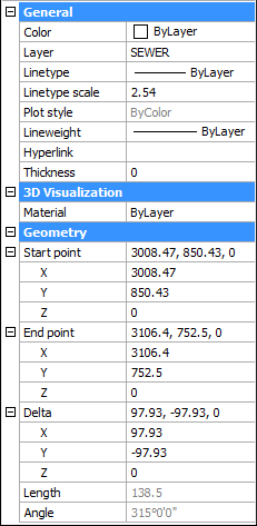

To edit the endpoints of a line
Select the line.
On the Properties Bar, under Geometry, do one of the following:
Select the X-, Y- or Z- field, then enter a value.
Select either Start
point or End point.
An X indicates the point being edited.
Click the Pick
Point button (
Specify the point in the drawing.

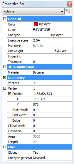

To edit the vertices of a polyline
Select the polyline..
On the Properties Bar under Geometry, select Vertex.
Click the Next/Previous arrow buttons to select a
vertex.
An X indicates the vertex being edited.
Do one of the following:
Select the X- or Y- field, then enter a value.
Under Vertex
select Position and click the
Pick Point button (
), then specify the point in the drawing.

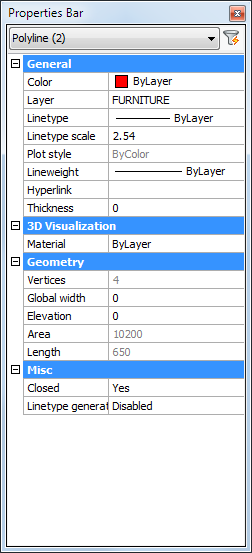

Edit the shared properties of a selection set
Select the entities.
The shared properties display in the Properties Bar.
Type a new value in settings field of the
property.
All selected entities are updated simultaneously.
(option) Repeat steps 2 and 3 to modify another property.
