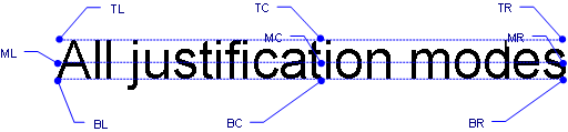

Justify
Displays all justification modes; prompts you:
Text: Style/Align/Fit/Center/Middle/Right/TL/TC/TR/ML/MC/MR/BL/BC/BR/<Start point> - enter an option.
  • TL - top left
  • TC - top center
  • TR - top right
  • ML - middle left
  • MC - middle center (equivalent to Middle).
  • MR - middle right
  • BL - bottom left (equivalent to Start Point).
  • BC - bottom center (equivalent to Center).
  • BR - bottom right (equivalent to Right).

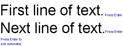

Text
Specifies the text.
Enter a line of text, and then press Enter.
The prompt repeats; enter more text.
Each additional line of text is positioned under the previous line.
Exit the command by pressing Enter at the 'Text' prompt.
