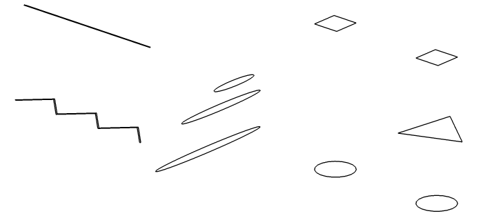

Cross sections (red) and guides (blues) |
Cross sections only |
All guides selected |
Cross sections (red). |
Cross sections selected only |
Curved solid edge selected as a guide. |

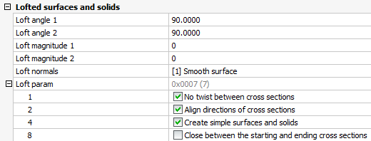

Allows to set the Loft surfaces and solids settings. The default settings are controlled through a series of system variables, which are saved in the drawing:
Loft Normals settings:
Prompts you: Current option is Smooth. Enter an option [Ruled/Smooth fit/Normal to/Draft angles] <eXit>:

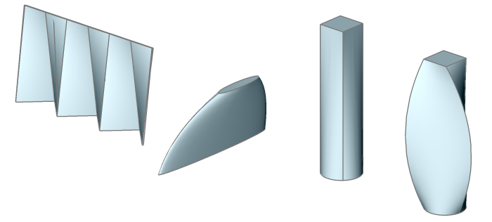

Solid surface is normal to the start (left), end (middle), both (right) cross sections
Loft Angles = 90° (left), Loft Angles = 0° (middle), Loft Angles = 180° (right)
