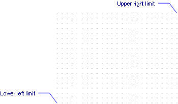

Limits the extent of the drawing and the grid.

The area also defines the extent of the grid display, whether limits are turned on or off, if the Display beyond limits area flag of the GRIDDISPLAY system variable is not set.

Specifies the lower left corner of the limits. |
Specifies the upper right corner of the limits. |
Grid - uses the limits to specify the extent of the grid display.
