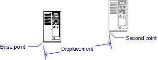

Enter base point [Displacement] <Displacement>: (Pick a point, enter x,y coordinates, or type D.)
Enter second point <Use base point as displacement>: (Pick another point, or press Enter.)
Option |
Description |
Specifies the entities to be moved. |
Specifies the starting point. Pick a point in the drawing, or enter x,y coordinates. Use entity snap modes to ensure accuracy. To move entities horizontally or vertically, hold down the Shift key. |
Specifies the destination for the entities. Pick a point in the drawing, or enter x,y coordinates. |
Specifies the displacement vector to move the entities; prompts you: Enter displacement vector <100,200,0> - Enter x,y,z coordinates to specify the displacement vector from the origin of the current UCS. The z-coordinate is optional. If not specified z = 0. |
Uses the x,y,z coordinates of the base point to define the displacement vector. |
