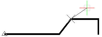

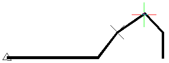

Inserts a vertex; prompts you: Location of vertex - pick a point for the new vertex. The drag line previews the location of the new vertex.
BricsCAD adds the vertex and segment.

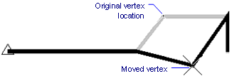

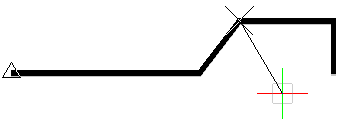

Moves the current vertex; prompts you: New location for vertex - pick point to move the vertex. The drag line previews the new location of the vertex.
BricsCAD moves the vertex and associated segments.
It is easier to move vertices using grips. |
