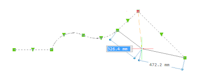

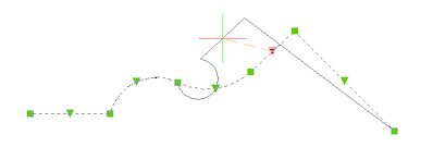

Polylines can be edited directly through grips:

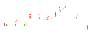

  1. Select the polyline. Notice that it has a square grip at each vertex (1) and a triangular grip at the midpoint of each segment (2).
  1. Do one of the following:
  2. Drag the midpoint grip of a line segment to move the segment.

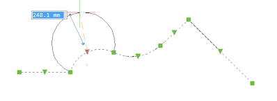

  3. Drag the midpoint grip of an arc segment to modify its radius.
  4. Drag a vertex grip to move the selected vertex.

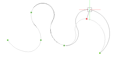

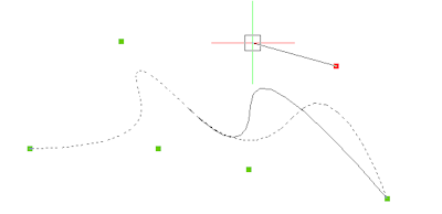

  5. Splined polylines have a grip at each control point, which can be stretched:
Cubic or Quadratic splined polyline.
Curve fit splined polyline.
