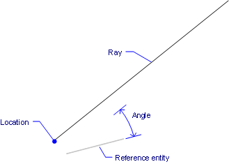

Draws rays at angles; prompts you: Reference/<Enter angle (0)> - enter an option. |
Reference |
Draws rays at an angle relative to another entity; prompts you: Select reference entity - choose a line. The line provides the reference (base) angle. Enter angle - specify the angle, measured relative to the entity. Location - specify the angle's start point; need not coincide with the entity's end points.
The 'Location' prompt repeats for drawing multiple rays at the same angle. |
Enter angle |
Specifies the angle; enter an angle or pick two points to indicate the angle; prompts you: Location - specify the starting point of the ray.
