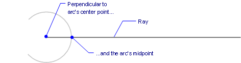

Entity |
Draws xlines perpendicular to the midpoint of lines and polyline segments, and the center point of arcs and polyarcs; prompts you: Select line,arc, or polyline segment to bisect - select a line, an arc, a polyline segment, or a polyarc.

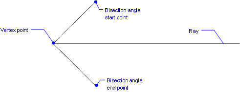

Vertex point |
Draws xlines that start at the vertex point and bisect two pick points; prompts you: Bisection angle start point - specify one part of the bisection angle. Bisection angle start point - specify the other part of the bisection angle.

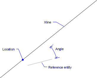

Draws xlines at angles; prompts you: Reference/<Enter angle (0)> - enter an option. |
Reference |
Draws xlines at an angle relative to another entity; prompts you: Select reference entity - choose a line. The line provides the reference (base) angle. Enter angle - specify the angle, measured relative to the entity. Location - specify the angle's start point; need not coincide with the entity's end points.
The 'Location' prompt repeats for drawing multiple infinite lines at the same angle. |

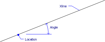

Enter angle |
Specifies the angle; enter an angle or pick two points to indicate the angle. Prompts you: Location - specify the starting point of the xline.
