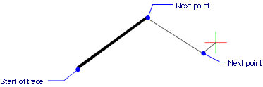

Width of trace <0.5000>: (Enter a number, pick two points, or press Enter to accept the default.)
Start of trace: (Pick a point, or enter x,y coordinates.)
Next point: (Pick another point.)
Next point: (Press Enter to exit the command.)
This command draws line segments in an unusual manner.
The trace is not drawn until the second pick point.
The delay allows BricsCAD to determine the mitering needed at vertices.
