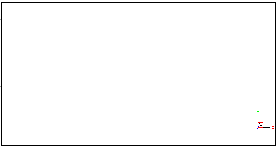

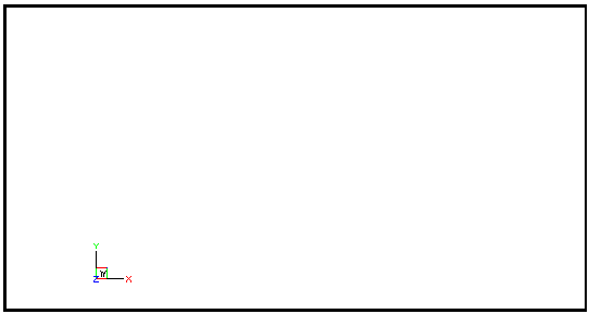

Displays the UCS icon at the origin (0,0).
When the origin is outside of the viewport, the UCS icon is displayed at the lower-right corner of the viewport.
Displays the UCS icon in the lower right corner of viewports. |
