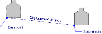

Enter Base Point
Specifies the point from which to copy.

Displacement
Specifies the distance to position the copy; prompts you:
Enter displacement point <0.0000,0.0000,0.0000> - enter x,y,z coordinates, or pick a point.
Enter Second Point
Specifies the destination of the copied entities.
