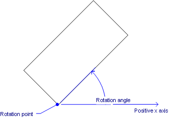

Rotation point: (Pick a point or enter x,y coordinates.)
Base angle/<Rotation angle>: (Enter an angle, or type B.)
Chooses the entities to be rotated. You can choose one or more entities using any entity selection method. Press Enter to end entity selection. |
Specifies the point about which the entities will rotate. Pick a point, or enter x,y coordinates. Use entity snaps for an accurate rotation point. |
Specifies the angle by which to rotate the entities:
Positive numbers rotate entities counterclockwise from the positive x axis. |
