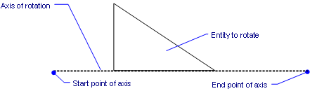

Specifies the start point of the axis of rotation. |
Specifies the endpoint of the axis of rotation. |

Specifies the angle by which to rotate the entities:
Positive numbers rotate entities counterclockwise from the positive x axis. |
