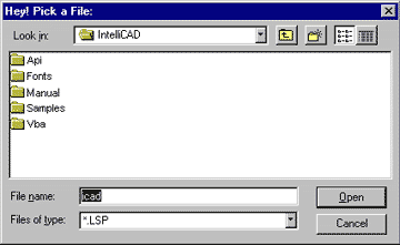

The title argument is the title of the file dialog box; this appears on the title bar. To create a blank titlebar, type " ", but you cannot leave the argument blank.
The filename argument is the default filename that appears highlighted in the File name portion of the dialog box. For no filename, type " ", but you cannot leave the argument blank.
The ext argument specifies the filetype, such as "dwg", "txt", or "lsp". When the argument is " " , no filetype is specified. To specify all filetypes, use "*" for the argument.

(getfiled "Hey! Pick a File:" "ICAD" "LSP" 4)
