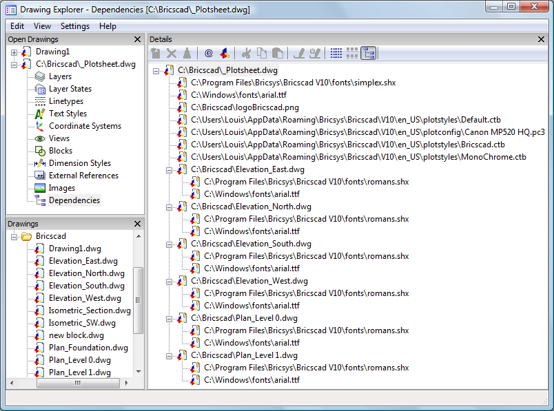

File| eTransmit/eBridge
Settings | Dependencies

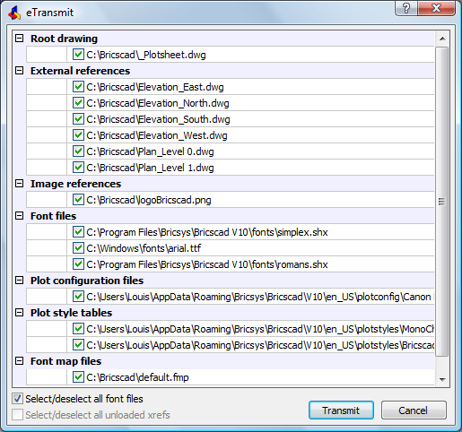

A dialog box displays:
Select the files to be included in the eTransmit package, then click the Transmit button.

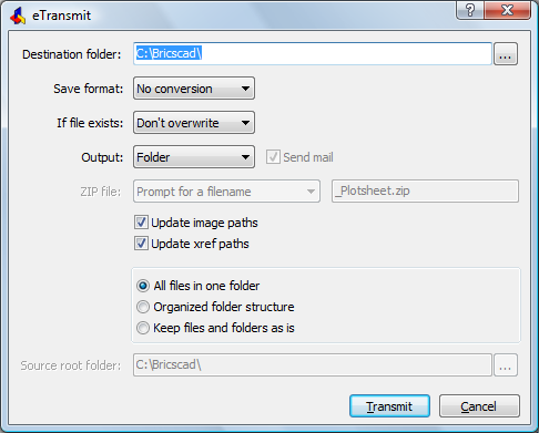

Adjust the settings, then click the Transmit button.

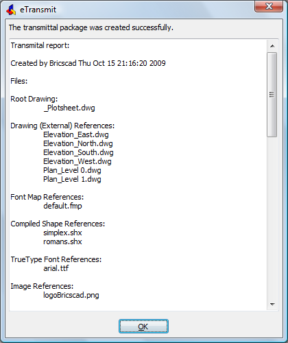

Displays a report:
eTransmit Command Options
Destination folder: |
Specifies the output folder for the eTransmit package. If the destination folder does not exist, you are prompted to create the folder. |
Save format: |
Specifies the format of the drawing files in the eTransmit package.
If file exists: |
Specifies what to do if a file already exists in the output folder.
Output: |
Specifes whether to create a ZIP file or copy the files to the output folder.
Send email: |
If checked, sends an email with the zipped eTransmit package in attachment. This option is available if the eTransmit output is a ZIP file only. |
ZIP file: |
Specifies what to do if a ZIP file of the same name already exists in the output folder.
Update image paths |
If checked, the saved paths for image files are updated, according to the new location. |
Update xrefs paths |
If checked, the saved paths for xrefs are updated, according to the new location. |
All files in one folder |
All files in the eTransmit package are copied to the destination folder. |
Organized folder structure |
A hierarchical folder tree is created in the destination folder |
Keep files and folders as is |
Keeps the folder structure of all files in the eTransmit package. This procedure allows to easily install the package on another computer using the folder structure of the source system. |
Source root folder: |
Specifies the source root folder for relative paths of drawing-dependent files, such as xrefs or image files. |

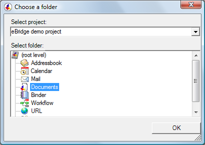

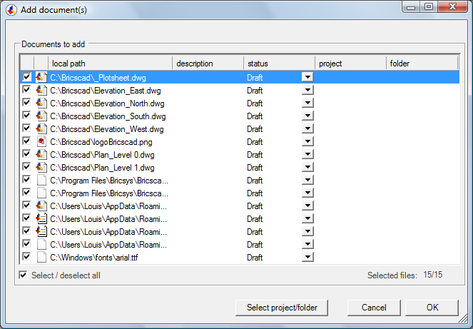

Click the Select project/folder button.
Select a folder, then click the OK button.
Click the OK button on the Add document(s) dialog box.

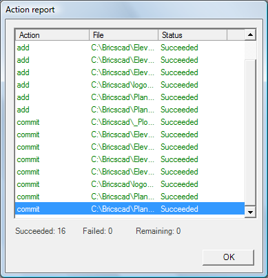

Displays a report:
Click the OK button to close the report dialog.
eBridge Command Options
Select a document, then double click the description field to add a description.
