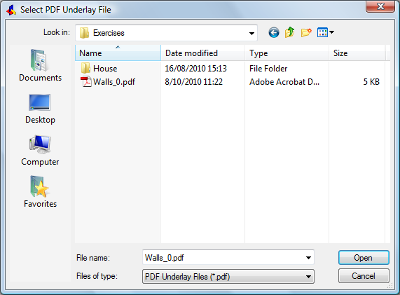

Displays the Select PDF Underlay dialog window.
Select a PDF file, then click Open.
Bricscad displays a dialog box:
Name
Specifies the name of the attached PDF file.
If more than one PDF file has been attached to the drawing, their names are listed by the droplist.
Browse
Choose a PDF file, and then click Open.
