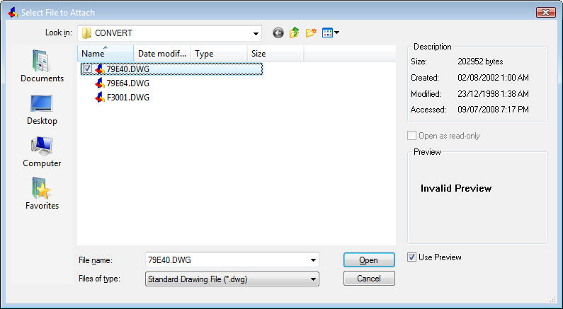

Choose a DWG file, and then click Open.

Attaches xrefs to the current drawing; displays the Select File to Attach dialog box. Choose a DWG file, and then click Open. Bricscad prompts you in the command bar: Insertion point for block - pick a point, or enter x,y coordinates. Corner/XYZ/X scale factor - enter an option, a number, or press Enter for the default value. Y scale factor: < Equal to X scale> - enter an option, a number, or press Enter for the default value. Rotation angle for block - enter a number, or press Enter for the default value. See Insert command. |
