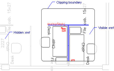

When you enter New, the following options appear:
[Select polyline/Polygonal/Rectangular] <Rectangular>: (Type S, P, or R.)
Prompts for Rectangular option:
Specify first corner: (Pick a point in the drawing, or specify x,y coordinates.)
Specify opposite corner: (Pick another point in the drawing, or specify x,y coordinates.)
The hidden portion of the xref is shown in gray for illustrative purposes only; it is normally not seen when clipping is turned on.
