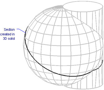

Section made in the current view plane:
Sections are made of regions, and can be manipulated as independent entities:

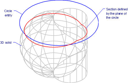

Object
Creates the section from entities that intersect the 3D solid; prompts you:
Select a circle, ellipse, arc, 2D-spline, or 2D-polyline - choose an entity.
You can also use elliptical arcs.
The entity defines the plane through which to create the section.

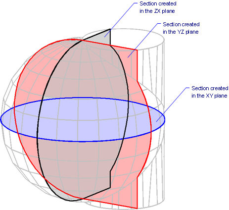

XY
Creates a section parallel to the x,y plane; prompts you:
Specify a point on the XY-plane - pick a point to define the height of the section above or below the x,y plane.
YZ
Creates a section parallel to the y,z plane; prompts you:
Specify a point on the YZ-plane - pick a point to define the height of the section above or below the y,z plane.
ZX
Creates a section parallel to the z,x plane; prompts you:
Specify a point on the ZX-plane - pick a point to define the height of the section above or below the z,x plane.
