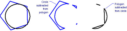

The result depends on the order in which ACIS entities are selected.
Select the sphere, and then subtract the cylinder:
Select the cylinder, and then subtract the sphere:
This command also applies to regions:
