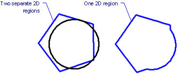

This command also applies to regions:
Specifies the ACIS entities to join into a single entity. Choose one or more 3D solids and/or 2D regions. The resulting entity takes on the properties of the ACIS entity selected first. This command also joins regions and 3D solids into a single entity. |
