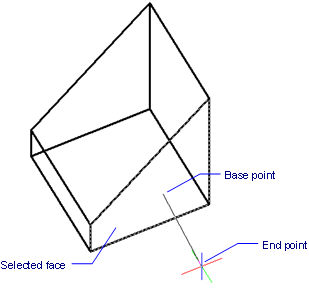

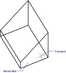

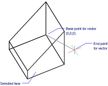

Moves the selected face; prompts you: Select faces: Remove/Undo/ALL - choose the face(s) to change. Select faces: Remove/Undo/ALL - press Enter to continue.
Specify <Base point>/Vector - pick a point, enter x,y,z coordinates, or type V. Specify end point - pick another point.
See Move command. |
Specifies the displacement through a vector measured from the origin (0,0,0) to the cursor's pick point; prompts you: Specify end point - pick a point or enter x,y,z coordinates.

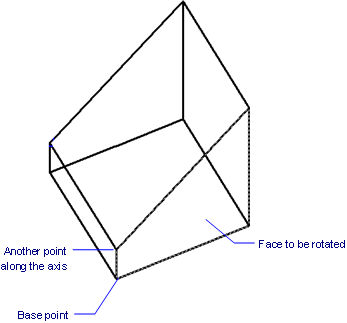

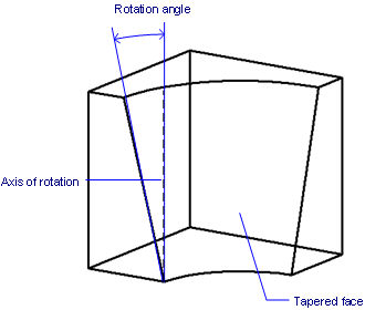

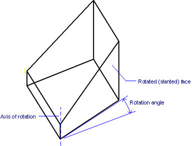

Slants the selected face about an axis; prompts you: Select faces: Remove/Undo/ALL - choose the face(s) to change. Select faces: Remove/Undo/ALL - press Enter to continue.
Specify the base point - pick the first point of the axis of rotation. Specify another point along the axis - pick the axis of rotation's second point. Specify the rotation angle - enter an angle:
See Rotate command. |

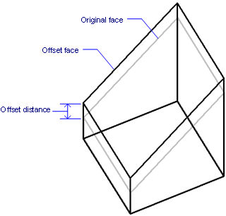

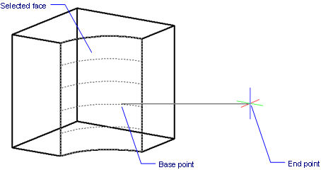

Extends the selected face; prompts you: Select faces: Remove/Undo/ALL - choose the face(s) to change. Select faces: Remove/Undo/ALL - press Enter to continue.
Specify offset distance - enter a distance:
See Offset command. |

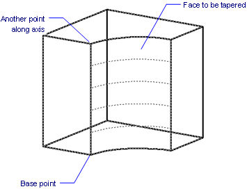

Tapers the selected face; prompts you: Select faces: Remove/Undo/ALL - choose the face(s) to change. Select faces: Remove/Undo/ALL - press Enter to continue.

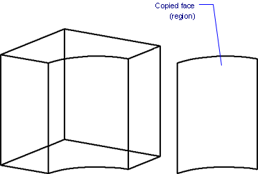

Copies faces; selected faces turn into regions. Prompts you: Select faces: Remove/Undo/ALL - choose the face(s) to change. Select faces: Remove/Undo/ALL - press Enter to continue.
Specify <Base point>/Vector - pick a point, enter x,yz, coordinates, or type V. Specify end point - pick another point.
To copy edges to lines, use the Edge |Copy option. |
Specifies the displacement through a vector measured from the origin (0,0,0) to the cursor's pick point; prompts you: Specify end point - pick a point or enter x,y,z coordinates. |

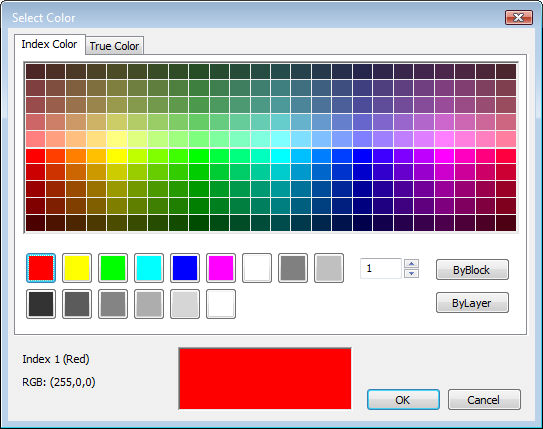

Changes the color of the selected face; prompts you: Select faces: Remove/Undo/ALL - choose the face(s) to change. Select faces: Remove/Undo/ALL - press Enter to continue. Displays the Select Color dialog box:
Choose a color, and then click OK. (Note: this option does not work.) |

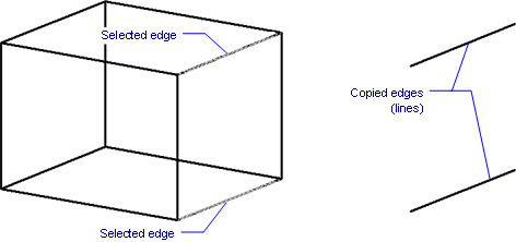

Copies the selected edge, and turns it into a line; prompts you: Select edges: Remove/Undo/ALL - choose the face(s) to change. Select edges: Remove/Undo/ALL - press Enter to continue.
Specify <Base point>/Vector - pick a point, enter x,y,z coordinates, or type V. Specify end point - pick another point, or enter x,y,z coordinates. Copied edges are turned into line entities. |

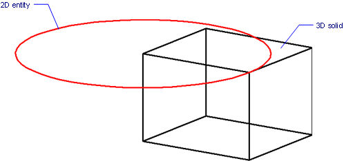

Imprints 2D entities onto 3D solids; prompts you: Select 3d solid - choose a 3D solid. Select an object to imprint- choose a 2D entity lying on or intersecting at least one face.
Delete the source object Yes/<No> - type Y or N.
Select an object to imprint - choose another 2D entity, or press Enter to end.
The 2D entity must lie on, or intersect, one of the 3D solid's faces. You can extrude the imprint.

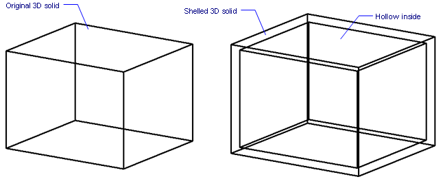

Turns the 3D solid into a hollow entity (shelled); prompts you: Select 3d solid - choose a 3D solid. Remove faces: Add/Undo/ALL - press Enter; removing faces creates unexpected results. Enter the shell offset distance - specify a distance:
If the shell offset distance is larger than the 3D solid, this command fails. |

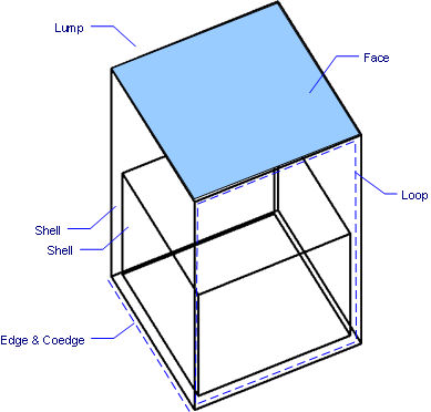

Reports on the 3D solid; prompts you: Select 3d solid - choose a 3D solid. A typical report looks like this: checked: 1 lumps 2 shells 0 wires 12 faces 12 loops 48 coedges 24 edges 16 vertices
