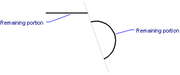

Chooses the entity to be trimmed. Select a single entity; only one entity can be trimmed at a time. Your pick point defines the portion of the entity to be removed.

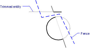

Cuts entities interactively; prompts you: First point of fence - specify the fence's starting point. Next fence point - specify the next point; press Enter to exit this option. As you pick fence points in the drawing, Bricscad immediately trims entities under the fence. The portion of each entity between other entities is trimmed:
Use this option together with ALL (select all entities to trim). |

Defines how intersections are projected; prompts you: None/Ucs/View - enter an option. This option affects the operation of the Edge option. |
None |
Intersections are not projected. Only those entities that intersect are trimmed. |
UCS |
Intersections are projected into the x,y plane of the current UCS. Entities that appear to intersect are trimmed. |
View
Intersections are projected along the current viewpoint. Entities that appear to intersect are trimmed. |
