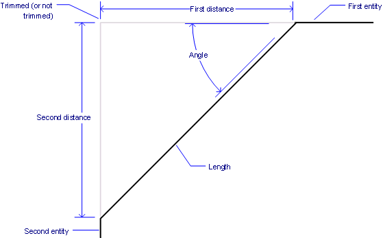

Chamfer (dist1=0.5000, dist2=0.5000): Settings/Polyline/Angle/Distance/mEthod/Trim/Undo/Multiple/<Select first entity>: (Select an entity, or enter an option.)
Select second entity: (Select another entity.)
Chamfered intersection.
Chamfered polyline.
Selects the first entity to be chamfered. Only open entities can be chamfered, with one exception: vertices of closed polylines can be chamfered with the Polyline option. This command cannot place a chamfer between two polylines,but it can place a chamfer between a line and a polyline, even a closed polyline. |
Selects the second entity. The two entities need not meet, but cannot be parallel to each other. |

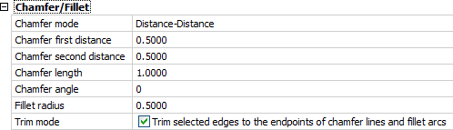

Displays the Settings dialog box for changing chamfer parameters. |

Prompts you for the Chamfer length and Chamfer angle in the command bar and sets the Chamfer mode to Length-Angle. |
Prompts you for the Chamfer first distance and Chamfer second distance in the command bar and sets the Chamfer mode to Distance-Distance. |
Prompts you to set the Chamfer mode in the command bar. The options are: Angle or Distance. |

Setting |
Chamfer Mode |
Determines how the chamfer is created:
Chamfer First Distance |
Specifies the default value of the first chamfer distance. |
Chamfer Second Distance |
Specifies the default value of the first second distance. |
Chamfer Length |
Specifies the default length of the chamfer. |
Chamfer Angle |
Specifies the default angle of the chamfer. |
Trim Mode |
Toggles whether intersecting entities are trimmed:
