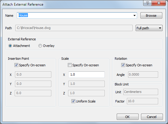

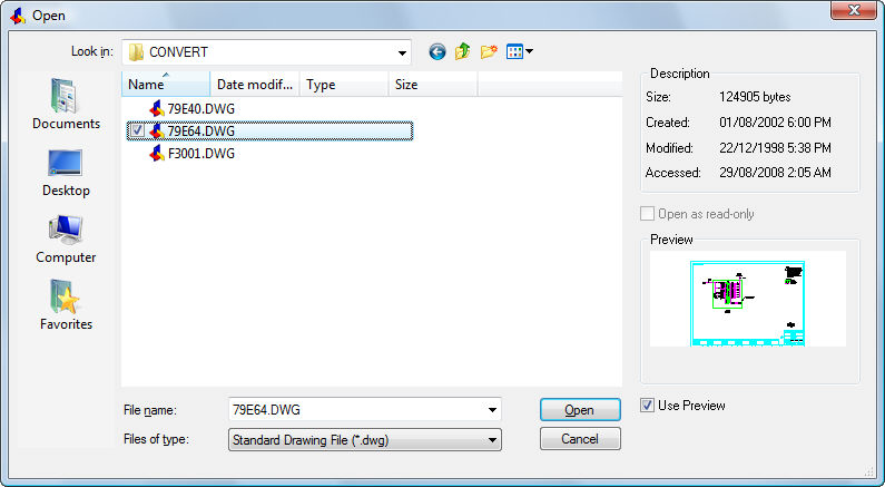

Choose a DWG file, and then click Open.
Bricscad displays a dialog box:
Choose options, and then click OK.
If you choose Specify On-screen, then you will be prompted in the command bar for the insertion point, scale, and/or rotation angle.
This command is a shortcut to using the -XRef command's Attach option.
Specifies the name of the attached drawing file. If more than one DWG file has been attached to the drawing, their names are listed by the droplist:
Choosing another name lets you modify the xref's properties. |
Browse |
Displays the Open dialog box. Choose a DWG file, and then click Open. Choosing another file lets you attach a additional drawings without leaving this dialog box. |
Reports the path that will be remembered by Bricscad. You cannot edit this field; instead, use the Browse button to modify the path to the file. |
Full Path |
Click the droplist to choose a different path type:
c:\cad\dwg\filename.dwg
..\filename.dwg This option does not work until the drawing has been saved at least once. (..\ means one folder higher.)
filename.dwg |
Specifies how the external reference is to be attached:
Specifies the location of the xref's lower-left corner. |
Specify On-screen |
Determines when the insertion point is specified:
Insertion point for block - pick a point or enter x,y,z coordinates.
X Y Z |
Specifies the x,y,z coordinates for the xref's insertion point. Use 0,0,0 to insert the xref at the drawing's origin. |
Specifies the size of the xref. |
Specify On-screen |
Determines when the scale factors are specified:
Corner/XYZ/X scale factor - enter an option, pick two points a number, or press Enter for the default value. Y scale factor: < Equal to X scale> - enter an option, a number, or press Enter for the default value
X Y Z |
Specifies the scale factors of the xref in the x, y, and z directions. Use 1,1,1 to keep the xref at its original size. |
Uniform Scale |
Makes the y and z scale factors equal to that of x. |
Specifies the rotation angle of the xref. |
Specify On-screen |
Determines when the rotation angle is specified:
Rotation angle for block - enter a number, pick two points, or press Enter for the default value.
Angle |
Specifies the rotation angle about the insertion point. Positive angles rotate the xref counterclockwise. Use 0 to keep the xref at it original orientation. |
