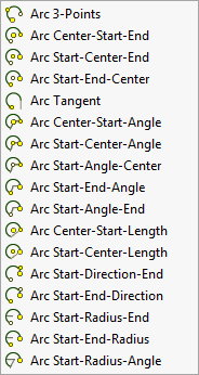

This command draws arcs by 17 methods. You can see the full list in the Draw | Arc menu and the Arcs toolbar:
