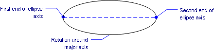

First End of Ellipse Axis
Specifies the first endpoint of the first axis.
Ellipses are defined by the length of two axes, or one axis and an angle of rotation.
Second End of Axis
Specifies the other end of the first axis.
Other Axis
Specifies the endpoint of the second axis, measured from the center of the first axis.
The longer of the two axes is called the "major axis"; the shorter one is called the "minor axis."

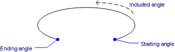

Start Angle of Arc
Specifies the start angle, creating the arc's starting point.
The angles are measured counter-clockwise from the positive x axis.
End Angle
Specifies the end angle, creating the arc's endpoint.
Included
Specifies the included angle, measured from the starting point.

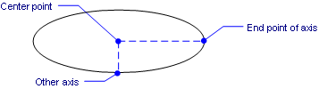

Center
Draws the ellipse starting with a center point; prompts you:
Center of ellipse - pick a point, or enter x, y coordinates.
Endpoint of Axis
Specifies the endpoint of one axis, measured from the center point.
Other Axis
Specifies the endpoint of the other axis, also measured from the center point.
