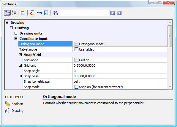

DSettings
Displays the Settings dialog box for drafting settings  (short for "drafting settings").
command bar:  dsettings
transparent:  'dsettings
alias:  settings
: dsettings
Displays the Settings dialog box at the Drafting section:
Change settings, and then click X.
Coordinate Input
Orthogonal Mode
Toggles orthogonal mode:
  • On - constrains cursor movement to the vertical and horizontal.
  • Off - moves cursor freely.
Hold down the Shift key to turn on ortho mode temporarily; alternatively, double-click ORTHO on the status bar.
Tablet Mode
Toggles tablet mode:
  • On - uses tablet for drawing input.
  • Off - uses tablet for command input.
Snap/Grid
Grid Mode
Toggles the grid display:
  • On - displays the grid.
  • Off - does not display the grid.
To toggle the grid display, you can click GRID on the status bar.
Grid Unit
Specifies the spacing between grid dots:
  • X - specifies the distance in the x direction.
  • Y - specifies the distance in the y direction.
Snap Angle
Rotates the snap and grid relative to the current UCS.
Snap Base
Locates the origin of the snap and grid relative to the current UCS:
  • X - specifies the x coordinate.
  • Y - specifies the y coordinate.
Snap Isometric Pair
Specifies the current isometric plane:
  • Left.
  • Top.
  • Right.
Snap Mode
Toggles snap mode:
  • On - constrains cursor movement to the snap distance.
  • Off - allows cursor to move freely.
To toggle snap mode, click SNAP on the status bar.
Snap Style
Specifies the snap style:
  • Rectangular snap - sets snap and grid to rectangular.
  • Isometric snap - sets snap and grid to isometric; adds the Isocircle option to the Ellipse command.
Snap Type
Specifies the snap type:
  • Grid snap - restricts cursor movement to x and y snap distances.
  • Polar snap - restricts cursor movement to angles.
Snap Unit
Specifies the spacing between snap points:
Entity Snap Coordinates
Determines whether coordinates entered by the keyboard have priority over entity snaps:
  • Entity snap settings override keyboard coordinate entry.
  • Keyboard entry overrides entity snap settings.
  • Keyboard entry overrides snap settings except in scripts.
Polar Distance
Specifies the polar distance; effective only when Snap Type is set to Polar Snap.
