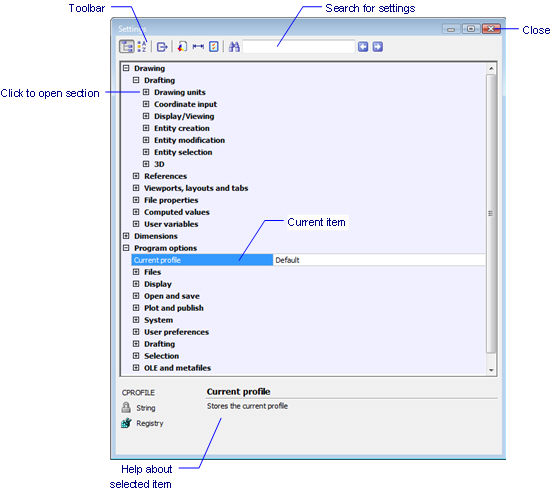

Settings
Changes the values of system variables through a dialog box.
command bar:  settings
aliases:  ddrmodes, rm, dsettings, ddsetvar
menu bar:  Settings | Settings
toolbar:  Settings |
: settings
Changes to settings are applied immediately.
Click X to close this dialog box.
Categorized
Lists system variables in categories:
  • Drawing.
  • Dimensions.
  • Program Options.
Alphabetic
Lists system variables in alphabetical order.
Export
Exports system variables and values in CSV format.
Displays the Export Settings dialog box:
CSV is short for "comma separated values."
 Drawing
Jumps to the Drawing section of the dialog box.
 Dimensions
Jumps to the Dimensions section of the dialog box.
See DimStyle command.
 Program Options
Jumps to the Program Options section of the dialog box.

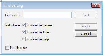

Opens Find Options
Provides additional options for finding system variables.
Displays the Find Setting dialog box:
Find What
Specifies the text to find.
Enter any text, and then click Find.
Find Where
Restricts the search to:
In variable names
Names of system variables, such as "AFLAGS."
In variable titles
Descriptive titles of variables, such as "Attribute options."
In variable help
Help text for system variables, such as "Sets default values for attribute creation."
Match case
Toggles case matching:
Yes - matches the case. For instance, "AFLAGS" must be all uppercase.
No - does not match the case. For instance, you can search for "aflags" or "AFlags."
Find
Finds the text entered in the Find What box.
Apply
Applies changes made to options.
 Find
Specifies the text for which to search.
As you enter text, Bricscad immediately find the first instance.
Click the button to find the next instance.
Color coding indicates the search status:
 (white) - another instance of the search term exists.
 (green) - the search has reached the first term again.
 (orange) - the search text does not exit.
 Find Previous
Finds the previous instance of the text.
 Find Next
Finds the next instance of the text/
 Close
Exits the dialog box.
