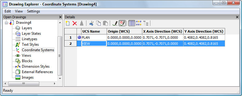

Displays the UCS section of the Drawing Explorer dialog box:
Create or modify named UCSs, and then click X.
Press F1 to access help.
UCS Name
Lists the names of UCSs in the drawing; click to rename.
UCS is short for "user-defined coordinate system."
Origin (WCS)
Reports the origin (0,0,0) of the UCS in x,y,z coordinates of the WCS; cannot be edited.
WCS is short for "world coordinate system."
X Axis Direction (WCS)
Reports the direction of the x axis in WCS coordinates; cannot be edited.
Y Axis Direction (WCS)
Reports the direction of the y axis in WCS coordinates; cannot be edited.
Current
Indicates the current UCS.
